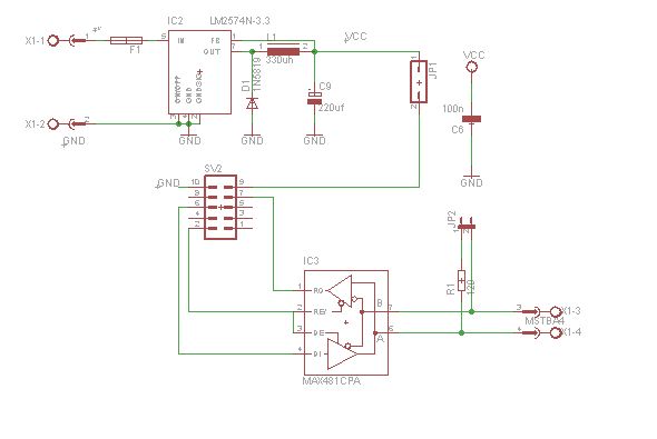

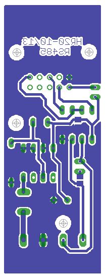

I´ve build a RS-485 interface with a 3,3 volt step down converter for
the HR20.
It uses pin PE2 to switch the send/receive pin.
It works for me just with a little change of the openhr20 software.
I also have a schematic and layout for a RS232 - RS485 converter which i
use to access my hr20 valves.
regards   uwe

@B0B81:
I did following:
1. I switched the "send" functions from the HR20 off.
    Now nothing is send when there´s no order.
2. I give every HR20 a number
3. In the receive function, the HR20 is checking the number
    (first received byte), if it is different:  do nothing.
4. When the HR20 answers, the first byte is his number.
I control the hr20s with a plc but i think this makes no difference.
Regards  Uwe
