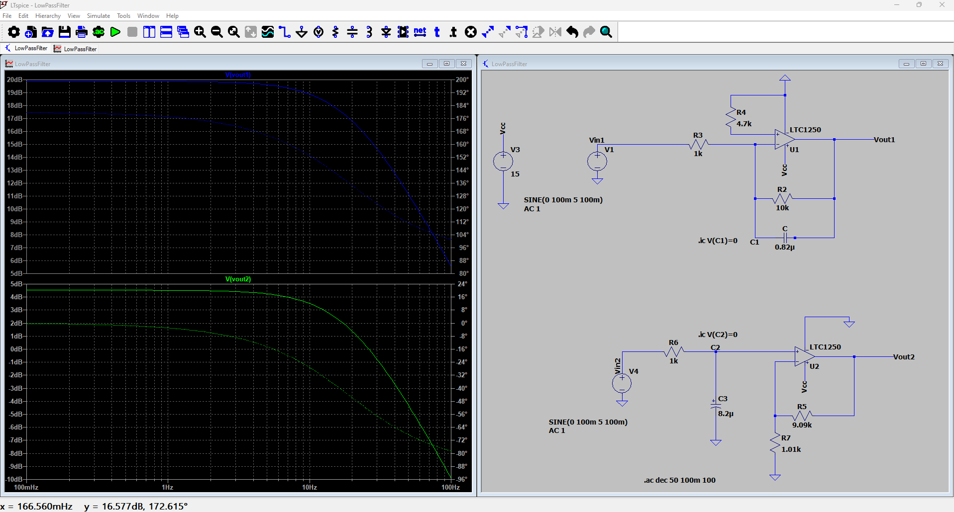

Hello µC community,
I'm using LTspice to design a low-pass filter using an OpAmp. However,
I've encountered an issue where the amplitude outputs u1 and u2 are
equal, despite their intended 10x amplification. The second picture
illustrates that the frequency response of OpAmp U1 and U2 are not the
same.
I'm seeking assistance to understand this result better. Any insights or
explanations would be greatly appreciated. Thank you!

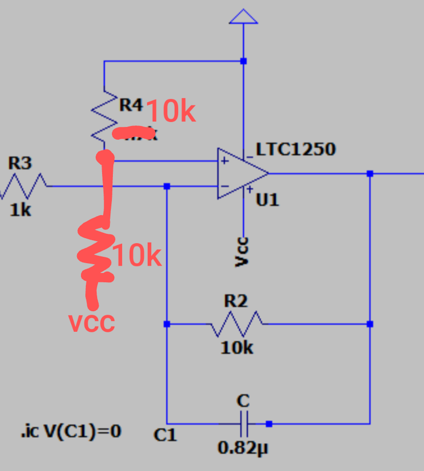

Both circuits demand a dual power supply. At least the inverting
amplifier/filter is very easy to modify for single supply by biasing the
(+)-input of the op amp with Vcc/2.

von Achim M. (minifloat)
Rate this post
useful
not useful
Hi,
see attachment, how it could be done.
br, mf

Ahmad K. wrote:
> "for single supply by biasing the (+)-input of the op amp with Vcc/2." I
> don't understand what do you mean in this sentence
That means, with single supply, the (+)-input of the op amp cannot be
connected directly to GND (= 0 V). You have to apply Vcc/2 (= 7.5 V)
instead. Don't forget to AC couple the source V1 (and eventually the
load).

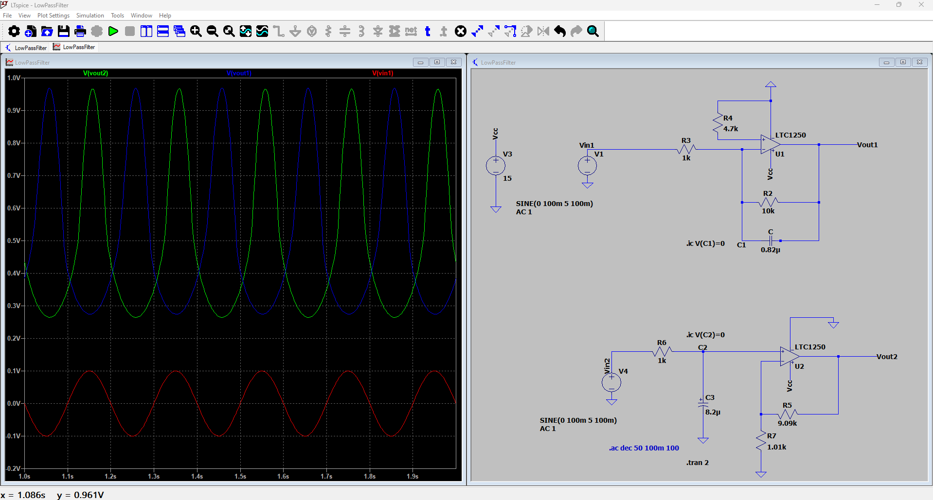

Ahmad K. wrote:
> The circuit works perfectly.
Your own plots tell a different story. Gain factors do not match and
output voltages are completely distorted. That's the exact opposite of
perfect.
You apply a +/-100 mV peak AC voltage at the input. When the voltage is
at +100mV peak, the output of the inverting amplifier would have to go
to -1 V peak. Same thing would have to happen with the non-inverting
amplifier when the input voltage is at -100 mV peak. That is impossible
with single supply.
The inverting amplifier has a few additional flaws. The LTC1250 is a low
1/f noise, zero-drift amplifier. Trying to cancel the effect of bias
current with R4 doesn't work the same as with other generic op amps. In
reality you make it worse by using R4 at all.
The op amp has an internal nulling circuit that's using the external
resistor R2 to close the loop. The loop needs a certain bandwidth (at
least 7 kHz) to work. You are impeding that by lowering the bandwidth to
~20 Hz because of C= 820 nF across R2, which in turn results in an
increase of 1/f noise and offset voltage.

Robert M. wrote:
> perfect.
Yes - a TRAN simulation (time domain) will reveal these distortions.
Note that the ac simulation (frequency domain) is a small signal
simulation only.
