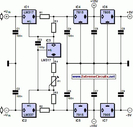

I need a dual power supply for experiments with opamps. In order to not
blow up my circuits too early I'd like to have some way to adjust a
current limit.
The LM317 (and LM337) datasheet shows a current limiting application
using a resistor from output to adjust pin. Based on that I also found
the following circuit, which seems to serve my purpose pretty nicely:
https://www.eeweb.com/adjustable-current-limit-for-dual-power-supply/
The thing is, that the current sensing resistor (as they call it) at the
output of the regulator gets the total current. That requires a special
low value, high power part that I don't have in my collection and that
seems bulky and expensive.
Can someone point me to alternative designs that don't require power
resistors and are still similarly simple?

giselach wrote:
> That requires a special low value, high power part that I don't have in
> my collection
That's life.
Connect a few that you have in parallel to solve that problem.
Every other circuit will also have a problem that you don't have all the
parts, and as you are too lazy to buy anything, there will be no
solution.
I don't like your current limiting circuit, but an LM3080 will not help.
