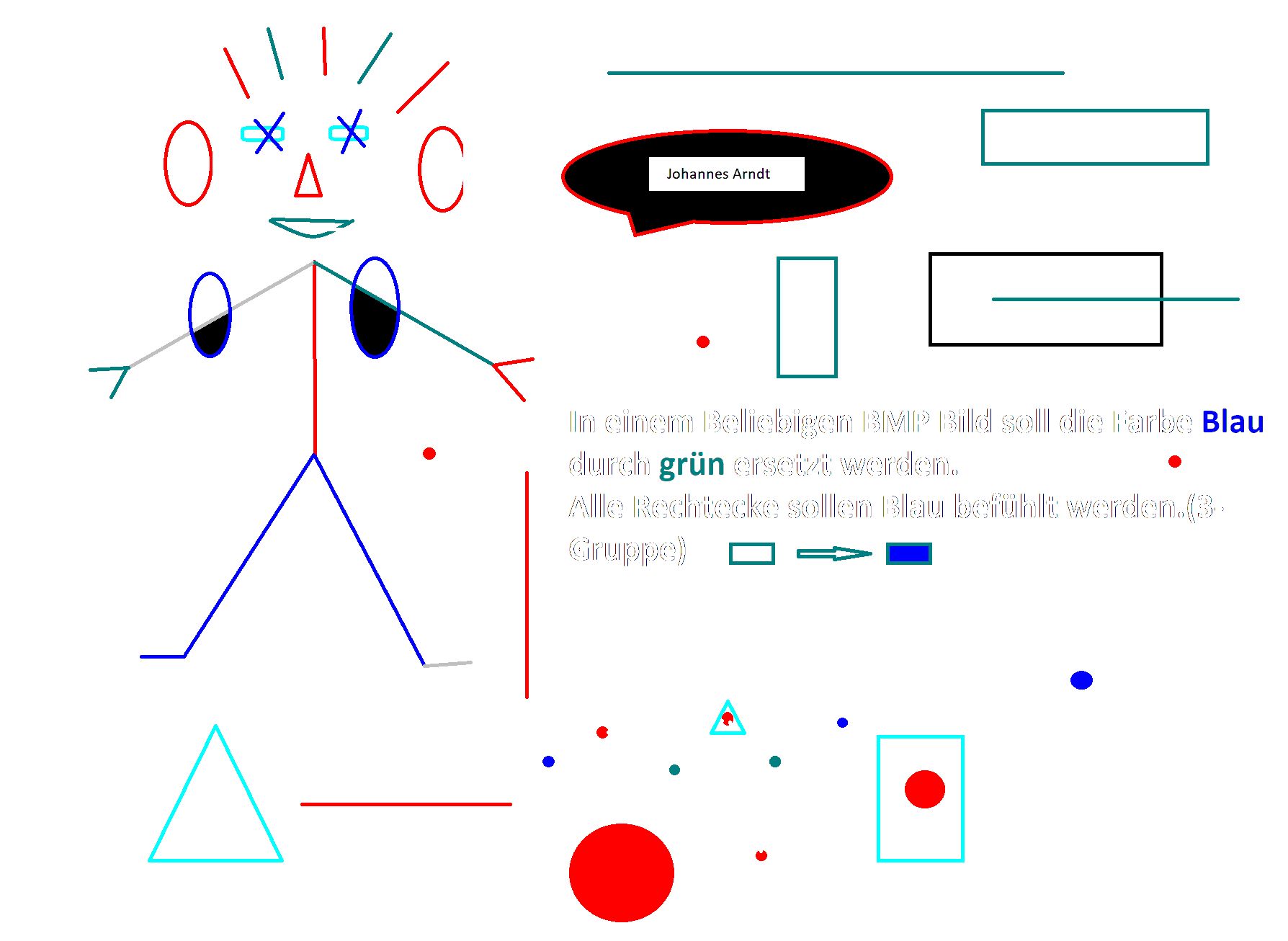

The first part of this kinda stupid exercise is fairly easy: examine the
structure of the bmp file to find out what index green and blue have and
where the picture data starts, then open it, read it, replace the
corresponding nibbles and write it to a new file.
To find and afterwards fill random rectangles is not that easy,
especially when they may be rotated in any way.
