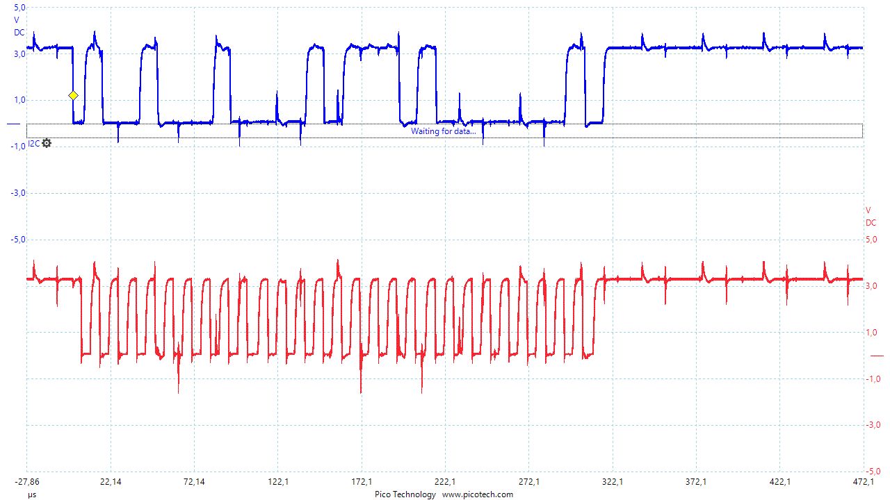

I'm building a fan controller for a vintage computer and I'm facing some
difficulties isolating the I2C bus and the motor PWM.  When I have a fan
connected to the output, spikes are being introduced into the I2C bus
which sometimes causes misreadings of the LM75A sensor data.  Can anyone
suggest a simple way how I can decouple the two parts of the circuit
better?
Please see the attached schematics and an image from my oscilloscope
that shows the spikes.
Thanks!
Hans

- reduce the pullups to 1k instead of 4k7
- disconnect the 100nF at the diode
- connect 100nF between 3.3V anf GND
Hans H. wrote:
> Can anyone
> better?
show us your layout. I guess there is a significant problem with it like
bad ground routing, no decoupling, signal paths next to power paths ...
2N7000 @ 3V3 GS can only drive <<100mA, it is only specified for 4.5V
and its maximum threshold voltage is 3.0V. You need a real logic level
Mosfet unless you use a toy ventilator with very minor current
consumption (like a few mA max).
