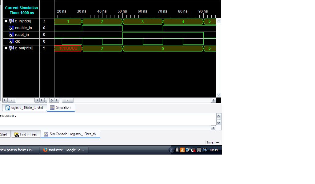

Hello everyone!. I have a problem!. I can't understand why do not work
how i hope it..
I have 2 components "registro_16bits" and "decoEstado"
on Registro_16bits:
when rising_edge of clock and enable is 1: I can write on Z_out the X_in
value; I don't have problem here.
the problem is when I connect decoEstado with registro_16bits.
decoEstado receives izq_in and der_in.
truth table:
izq_in | der_in  | z_out
     0          0      0
     0          1      0
     1          0      1
     1          1      0
my desing should to work:
when izq_in is 1 and der_in is 0 I should save x_in value and let get
out that value on z_out.
 I use decoEstado to assign enable_in on registro_16bits.
I'm apologize, but i don't speak english very well.. I hope u can help
me..
thanks
I attach the whole code and 2 TestBench Pictures!

I want to know why don't save the value "2" when the registro_16bits
receives enable_in = 1 and x_in = 2 on neurona_simple's testbench. I've
tested that on registro_16bits and all be ok!.

Congratiulations, you found the thing called "latency".
Aldemaro G. wrote:
> when the registro_16bits receives enable_in = 1 and x_in = 2 on
On (or better before!) the rising egde of "clk" the "enable_in" is '0'
and therefore "z_out" isn't changed. You see the very same behaviour at
the moment, when the value '4' doesn't appear on "z_out".
BTW: why so much modules and wiring for a thing you could write in
almost one line?
Thnks for the answer, but how can i calculate it?(can u recommend me a
book?) Because when i see both testbench, I think those (tb) receives
the same when rising_edge, :c

Aldemaro G. wrote:
> but i want to know why don't they behave same..
What doesn't behave the same?
My description of course behave like yours. I just wanted to show how to
shorten your nearly hundred lines of code down to one line...
> And how i can resolve it.
You must assign the values to "izq_in" and "der_in" well before the
next rising edge of "clk".
Or you must start to find the trick behind that "latency": at the rising
edge of the "clk" the registers attached to it take the values that you
see just before that edge. And if the enable signals are inactive just
before the "clk" then the registers won't change at all. Thats what you
see with your code, and thats the same with my code.
