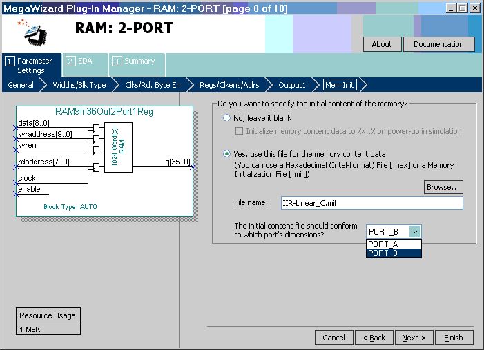

Yes i'm sure that is used in the Wizard. But I noticed that the Wizard
asks me this : The initial content file should conform to which port's
dimensions ? there are two ports A and B, but we can select only B.
What do you mean by enable the init-file ? and how?
Thanks in advance
#4083434
Look at my example: This is a dual ported and initialized RAM where the
written data (PORT_A) is 9 bits wide and the read data (PORT_B) is 36
bits wide. Thus I have to chose the Port. When both of your ports are
equal, then there is nothing to chose.
When you have a setting like in my example then it is obviously ok.
Obviously you have it, otherwise you wouldn't ask the previous question.
In that case I'd suspect next that something with the .MIF file is
wrong.
Did you have a close look that no corresponding warning appears, e.g.,
somthing like "File xyz.MIF not found"?
