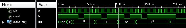

> when ever two consequtive data bytes are same
> then the next byte will be read as the length of the bytes.
enc: AA AA 00 FF FF
dec: AA AA FF FF
This is a little bit tricky, because here you have to "skip" one
cycle...
So, you can output Data with half the clock rate.
Or you can generate a "valid" signal parallel to the output data.
Or you can generate a clock signal that "clocks" out valid data (with
half the clock rate).
Here a solution for the 3rd way:

Result: see screenshot.

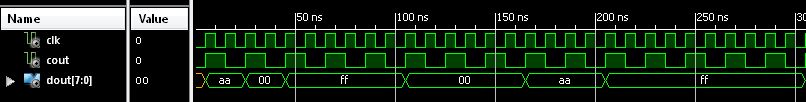

> Thanks a lot Lother Miller !
De nada.
Just a little remark: replace the "lastwnto" with "downto". It was a
search and replace lapse...  :-/
But my style would be the second one: generate a valid signal in
parallel to the clock and the data.

In the screenshot you must look at the rising edges of the clock an the
signal values before that. Those two belong togehter.
