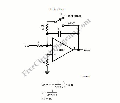

On the other hand I would like to have another option in my prototype,
because could be that the IVC102 won't work in the way I would like.
Then I was thinking to set up my own reset circuit + transimpedance Amp.
I mean i would like to design something like the picture attached
But the main problem of this circuit is to find a good switch with low
noise and good characterisitics...
Any advise?
Thanks
von ulrich (Guest)
Rate this post
useful
not useful
The switch really is a difficult part, because it needs to have low
charge injection and low leakage. However a very low resistance in not
needed - this could be in the 100 Ohms range. The obvious choice is a
CMOS switch. Against leakage it may be possible to use 3 switches in T
form: 2 in series and one to ground, so that the last switch will be
between the input and quasi- GND if off. So charge injection is the
really critical parameter.
With the rather large current from the detector the circuit is not that
critical as in original IVC102. Likely that capacitor will be larger and
the amplifier may be lower noise and faster, even if this would mean
more leakage current. So the requirements for the switch may be less
stringent.
I don't have an advice on a special part - just look at the
manufacutures (e.g. LTC, AD, Ti, Maxim) websites.
An alternative may be using a photomos switsch, though I don't know
exactly how good they really are. Also 2 JFETs may be possible, one as a
switch and one to compensate.
von Enrique P. (flote21)
Rate this post
useful
not useful
Thank you so much ulrich for your advise. I was taking a look and this
kind of switches seems to be good: ADG821.
They have low noise and combained with a good transimpediance OA could
give good results.
On the other hand there is another switched integretor + reset IC very
similar to IVC102 that but with a lower input offset voltage. This part
is ACF2101.
I will try several options in my prototype and then I will see which is
the best...
Thanks!
von ulrich (Guest)
Rate this post
useful
not useful
The ADG821 is a good switch for some applications that need a low
resistance, bud a really bad choice for such an integrator for small
currents. Low noise may be important with the amplifier, but low bias is
also important.
Something like a ADG1201 or ADG202 would be more suitable, though charge
injection is still much worse (at least guaranteed over full range) than
in the IVC102.
Rate this post
useful
not useful
Right the switch ADG1201 is really a better option. I will try with this
and the I will tell you something.
Thanks!
