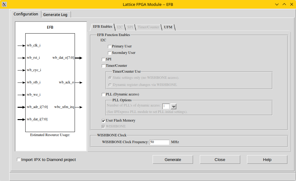

Hi everyone,
I'm having trouble accessing the internal UFM in a Lattice MachXO
device.
Here’s what I’ve tried so far:
First, I created my own Wishbone master, UFM controller, and integrated
them with the EFB block. The UFM controller is essentially a state
machine that reacts to inputs from the EFB block. It sends a sequence of
addresses followed by the required commands and operands.
The communication flow looks like this:
Other modules → UFM Controller → Wishbone Master → EFB Block
However, I didn’t observe any activity on the UFM.
So I tried a different approach using Mico8. I wrote a C program and
first verified the setup using GPIO, which worked correctly and
confirmed that the integration with the RTL modules was fine.
Next, I added the EFB block configured for Wishbone and inserted test
points in the C program to check whether the code was getting stuck
anywhere. The program successfully passed all the test points, but there
was still no response from the UFM.
I also used the UFM library available in LMS.
At this point, I’m starting to suspect that the internal UFM hardware
might not be functioning or enabled properly.
Has anyone encountered a similar issue or have suggestions on what I
might be missing?
Also, could someone share the correct configuration settings in the
IPexpress GUI for enabling and accessing the UFM through the EFB block?
cheers!
AM
Did you check with a simulation that your Wishbone master works
properly?
> properly?
Hi Rick,
Wishbone master works properly.
Really appreciated for the attachment. My IP express provides me with
sectors A, likely UFM0, UFM1 and so on.
well, I had a concern whether my internal hardware is up or not. so, I
came up with another move adding the softcore Mico8 and let the wishbone
connection would do the job. looking towards it.
Do you have anything should I need concern when proceeding?
AM
von Rick D. (rickdangerus)
Rate this post
useful
not useful
In simulation or in fabric?
And how did you know that it will work?
My screenshot is from MacoXO2, so it might differ.
On which addresses did you expect and access the UFM?
Did you have filled the UFM with a well known uniq pattern?

It sounds like the Wishbone side is alive, but the EFB/UFM bridge may
not actually be enabled in IPexpress. Double check clock routing, UFM
enable bits, and address mapping. I’d also verify BUSY/DONE status
handling because incorrect sequencing can silently ignore UFM
transactions.
