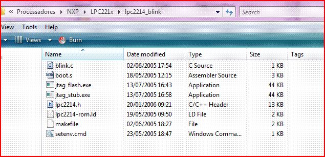

I'm sorry i can't solve it by myself, i'm not used with arm-elf-gcc and
these makefile commands. :/
the directory with the source and the error screenshot are attached,.

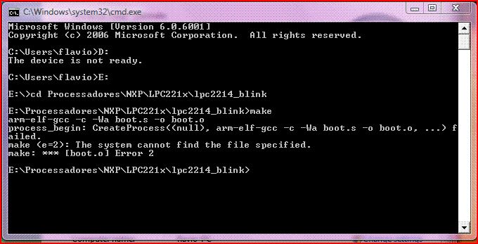

so the error is the following:
<after make command>
arm-elf-gcc -c -Wa boot.s -o boot.o
process_begin: CreateProcess((null), arm-elf-gcc -c -Wa boot.s -o
boot.o,...) failed.
make (e=2): The system cannot find the file specified.
make: *** [boot.o] Error 2

my path variable is the following:
%SystemRoot%\system32;
%SystemRoot%;
%SystemRoot%\System32\Wbem;
C:\Program Files (x86)\Microsoft SQL Server\90\Tools\binn\;
C:\Program Files\MATLAB\R2009b\runtime\win64;
C:\Program Files\MATLAB\R2009b\bin;
C:\GNUARM\bin;
C:\GNUARM\bin\utils\bin;
C:\GNUARM\bin\utils;
i tried again and it still happening

arm-elf-gcc.exe in located in c:\gnuarm\bin ? Try
start->run->cmd->arm-elf-gcc --version to check if the system finds the
executable. I don't know the latest version of GNUARM but there have
been issues with Vista but IRC at a later stage while linking. If the
executable is in the path but make still can not find the compiler you
may try another package, i.e. Yagarto (prefix still arm-elf AFAIK),
Codesourcery G++ lite (prefix arm-none-eabi-) or DevkitARM (prefix
arm-eabi). Adjust the prefix in the makefile if needed.

yes... thats what i did... now i'm using winarm on vista and it works
perfectly now :)
