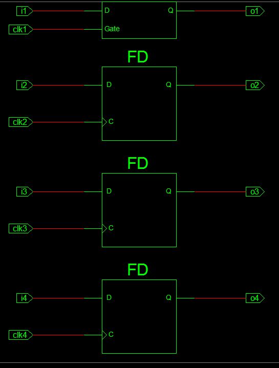

Now I synthesized this 4 descriptions with Xilinx XST:
1
entity ClockStyles is
2
    Port ( clk1 : in  STD_LOGIC;
3
           i1   : in  STD_LOGIC;
4
           o1   : out  STD_LOGIC;
5
           clk2 : in  STD_LOGIC;
6
           i2   : in  STD_LOGIC;
7
           o2   : out  STD_LOGIC;
8
           clk3 : in  STD_LOGIC;
9
           i3   : in  STD_LOGIC;
10
           o3   : out  STD_LOGIC;
11
           clk4 : in  STD_LOGIC;
12
           i4   : in  STD_LOGIC;
13
           o4   : out  STD_LOGIC);
14
end ClockStyles;
15
16
architecture Behavioral of ClockStyles is
17
begin
18
19
  process (clk1) begin
20
    if (clk1='1') then
21
      o1 <= i1;
22
    end if;
23
  end process;
24
25
  process (clk2) begin
26
    if (clk2='1' and clk2'event) then
27
      o2 <= i2;
28
    end if;
29
  end process;
30
31
  process (clk3) begin
32
    if rising_edge(clk3) then
33
      o3 <= i3;
34
    end if;
35
  end process;
36
37
  process begin
38
     wait until rising_edge(clk4);
39
     o4 <= i4;
40
  end process;
41
42
end Behavioral;
During synthesis I got a warning:
1
WARNING:Xst:819 ... The following signals are missing in the process sensitivity list:  i1
As a result I had a look on the RTL schematics (attachement).
The signal i1 was added automatically to the sensitivity list of process
#1 and therefore a latch was generated.
In contrast Christian said:
>> meanwhile, I've checked the RTL schematics and found them
>> to be equal in all 3 cases.
So here the Xilinx tools act very different to the Altera tools :-(
