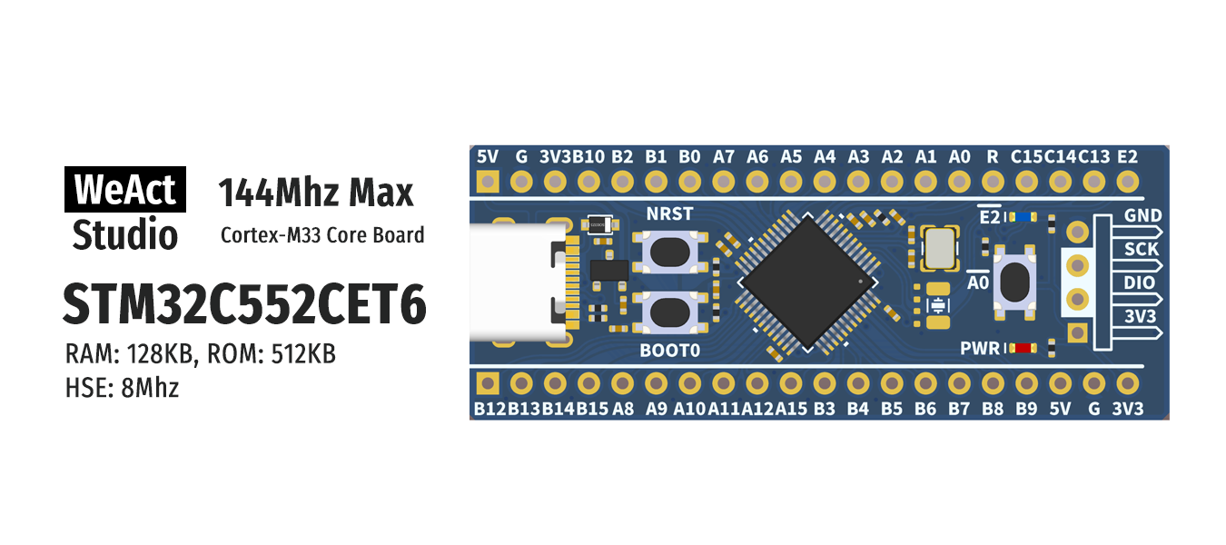

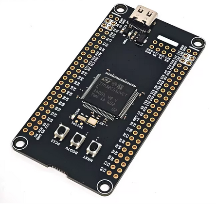

Hi all,
The STM32C5 microcontrollers feature an ARM Cortex M33F core with clock speeds up to 144 MHz. In addition to the usual ADC and DAC, they also include operational amplifiers, comparators, and a delay block. DSP instructions, an FPU , and the CORDIC coprocessor enable fast signal processing. Three models also include Ethernet.
The WeAct STM32C552VET6 100-Pin Core Board is offered on Aliexpress starting at €6.
The STM32C5 series was advertised in 2026 as a low-cost alternative to Chinese competitors. It was released alongside a new HAL2 and the new Cube MX2. Neither is backward compatible. Arduino does not yet support the STM32C5.
If someone is searching for instructions not using Cube HAL, then my private (non commercial) homepage might help:
https://stefanfrings.de/stm32/stm32c5.html
Klick on the "translate" link in the upper right corner below the butterfly.
It seems that there is no other website available providing similar instructions. The website was written in German, but Google Translator does a pretty good job.
