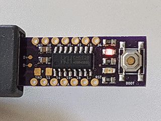

Ch55xduino is an Arduino-like programming API for the CH55X, a family of
low-cost MCS51 USB MCU. The project tries to remove the difficulty of
setting up a compiling environment. Users can simply write code in
Arduino IDE and hit one button to flash the chip to get code running. No
configuration or guesswork needed.
CH551/2/4 may be the lowest part count system that works with Arduino.
The minimal system only requires one chip, 2 decoupling capacitors, and
one optional pull-up resistor. These features made it ideal for DIY
projects.
At this moment the project is still working-in-progress. Support most
Arduino functions (Except pulse, shift, tone). Refer to examples in this
repo for more info.
https://github.com/DeqingSun/ch55xduino
