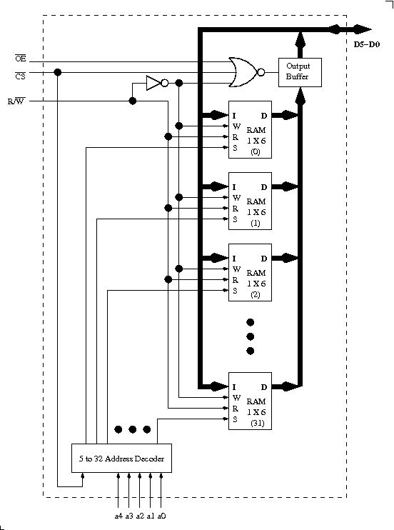

Hey guys I am trying to implement a 32x6RAM in VHDL and I swear
everything looks fine when after going through my source code but I
can't seem to figure out why I get a dangling signal/multiple source
error when I try to create S=>AD(0) to S=>AD(31)...Can anyone help me
point out what I may be forgetting in my code please?
Look for   Z=>AD
and for    S=>AD(0) ... S=>AD(31)
Thats a classical multi source with two drivers on one signal.
Why doing it the hard and stony way with thousands of manually
instantiated and handwired parts? Why not just using a RAM in
traditional style?

von mike m. (mikulski)
Rate this post
useful
not useful
Haha I appreciate your insight. The class is a senior level logic design
course which honestly isn't all that hard. However, the projects is
where the class becomes extremely time consuming as you can see...doing
a behavioral set-up like you just showed is a much easier way to
approach this, but we are strictly doing structural VHDL. I'm assuming
this is because he wants students to understand how all the parts play
together and such. The current format is how it must be done and the
project is due tomorrow at midnight. I feel if I can just fix this
multi-source issue I will be in the clear to create the final component
(64x6RAM).
I don't see how this multi-sourcing issue works. I figure the 5to32
decoder will disable 31 1x6RAMs while enabling one 1x6RAM. So having the
AD signal the way I wrote it makes sense but I am obviously a novice at
this.
If you understand my thinking on how this code works would you be able
to tell me what I should do to avoid/fix this multi-sourcing issue? I
have done c++/C/C#, and java but VHDL is not my cup of tea even though
it is not hard. I am new to VHDL and I can't see how to get around this
problem. The professor is helpful but wont give me the info that I need
to solve this problem.
Thanks in advance!

von Lothar M. (Company: Titel) (lkmiller) (Moderator)
Rate this post
useful
not useful
Yes, indeed. Very impressive and almost senseless... :-o
Why don't you instantiate a AND Gate and wire it manually there:
1
   Z <= not (A or B or C);
2
3
   Z <= A and B and C and D and E and F after 222 ps;
Are you allowed to use a behavioral statement like and or nor inside
a structural description? I cannot believe that its the intention of a
lecture to code a certain component in the most ugly way...
BTW: at least one error is found:
1
gate9   :  mmInvBuf  PORT MAP  (a=>DL(0), E=>A(1), Q=>IV(0));
2
gate10  :  mmInvBuf  PORT MAP  (a=>DL(1), E=>A(1), Q=>IV(0));
3
gate11  :  mmInvBuf  PORT MAP  (a=>DL(2), E=>A(1), Q=>IV(0));
4
gate12  :  mmInvBuf  PORT MAP  (a=>DL(3), E=>A(1), Q=>IV(0));
5
gate13  :  mmInvBuf  PORT MAP  (a=>DL(4), E=>A(1), Q=>IV(0));
6
gate14  :  mmInvBuf  PORT MAP  (a=>DL(5), E=>A(1), Q=>IV(0));
Lots of mmInvBuf driving an bunch of IV(0) ...

Would would I need to do to fix this multi source issue with only
altering the gates and signals? I cannot add any other components
unfortunately. Would I use inout for D in the 32x6RAM?
Could you show me what you would do please?
Rate this post
useful
not useful
D   : out    STD_LOGIC_VECTOR (5 downto 0));
D must be inout, because the picture shows data going in and also out.
I'm sorry, I already did...
I don't want to drill deep into a dozen of files instead of using less
than 20 lines to get the very same result.

Ok so I finally got everything to work HOWEVER I was wondering if you
could help me out debug these warnings. I have to do multiple test
benches on this program so I want to make sure everything is working
properly.
Ok so I get combinatorial loops in the mm32x6RAM module (gates 5-36),
Inout D(0)-D(5) is never assigned. tied to value Z in the 64x6RAM
module, and some weird error I have never seen before.
I have attached images of the errors and the vhdl files that correspond
to the errors
Rate this post
useful
not useful
There you have three very elementary problems:
First unused signals. That may be a result of a problem elsewhere,
having as a consequence that the now mentioned signals are unused.
Then a combinational loop. That may be a result of switching the
direction is not working properly.
And last the unassigned D. Thats the most astonishing thing. Something
with the disabling of the ports ist not working properly. That may cause
the first problem.
So, now what oyu MUST do is a simulation of your design! It makes
absolutely no sense to try to synthesize such a scattered design and try
to track down each one of the hundreds of signals inside...
